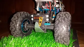

Stopped by LHS on the lunch to window shop. Had to get something. Walked out with a piece of .030 (I think, tossed the wrapper:() for $2.75 and made some skid plates to get rid of those horrid "bumpers".
I pulled off the stock bumper and layed it flat to trace on paper. Scanned it so I could play around with it in mspaint. I settled on classy and simple to compliment the body. Plus it I was able to knock it out in about 20 minutes with highly satisfying results. So far...
As far as function, I think they are durable enough and will deflect okay. Its not a heavy truck so we'll see. I'll chime back in with my results tomorrow. Me and my son take it everywhere with us on the weekends. Never know where you might find a nice juicy rock pile to crush.:eek::mad:o_O:oops::p
