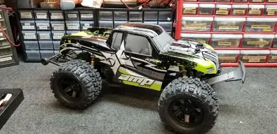

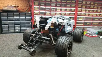

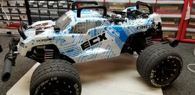

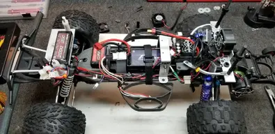

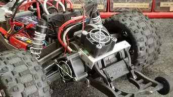

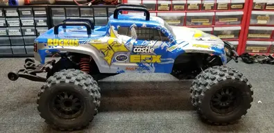

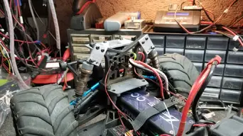

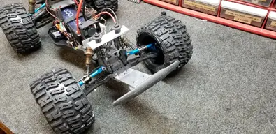

Hey all, I have the ECX AMP, Torment and Ruckus to name a few all running Castle combos and Gen Ace 7000 mAh 3S LiPo's. Fast, oh yes, lots of wheelies, oh yes, many broken parts, a few, only if you run into a curb or tree ect. Point is, you control the speed of the vehicle, you are the one pulling the trigger, you don't have to go full trigger. I do agree that a newbie's best bet is to go with a 2S, but don't be afraid to experiment, upgrade, redesign ect., that's what the hobby is all about. One nice thing about Castle combos is you can program them for slower speeds. Also, some radios have an option to turn the throttle down so the vehicle will only go so fast. ECX vehicles are great trucks/cars for newbies to get started in the hobby, but they GREAT vehicle when upgraded or redesigned. Keep the hobby alive.
