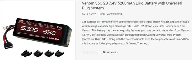

I don't want to tell you how to proceed, but I would recommend not bothering with another nimh battery. There is no benefit. Go to a 2s lipo and gain power and length of usable power.
I would recommend this:
https://www.venompower.com/collecti...00mah-LiPo-battery-with-universal-plug-system

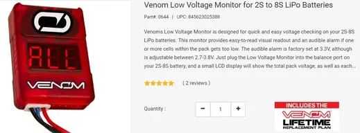

Also remember to run a low voltage alarm, as the stock Amp setup does not have one. Something like this:
https://www.venompower.com/products/venom-low-voltage-monitor-for-2s-to-8s-LiPo-batteries
+1 to that. I have an AMP (now converted to a Circuit) and have two Venom 4000mAh batteries and the venom LVM. The higher discharge rate of the LiPos really wakes up the AMP and deliver run times of about 45 minutes!
If you do get a LiPo battery, you will need a battery that can specifically charge LiPo batteries. I highly recommend the Hitec X1 Mini.
