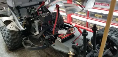

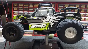

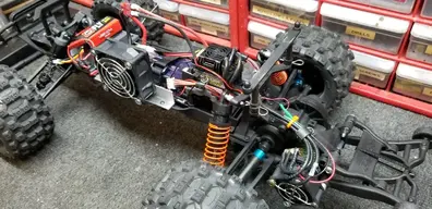

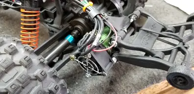

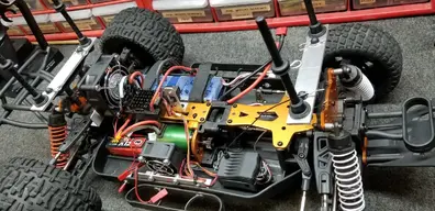

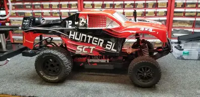

Hello Mr. Whiskers, great name. The Amp is an entry level (beginners) RC truck. It was my first RC vehicle and now i have 22. I learned from the Amp, all aspects of RCing, fixing, building, upgrading, and doing my own redesigning and modes. At this point of the game (I've been in the hobby for five years now) the AMP is one of my favorites. There is a world of knowledge out there on the RC forums and there are so many things you can do to make an RC vehicle better then how it came out of the box. Setting suspension, setting shocks, setting toe-in tow-out, tires. body lifts, the list goes on and on. Use your AMP to learn from, upgrade it, experiment with different size tires and so on.
My AMP runs a 3800KV Castle Combo brushless motor powered by a Gen Ace 7000mAh 60C/120C 3S battery, all metal transmission gearing, metal pinion and spur gears, lights for night running and BIG tires. The list goes on and on. Use your imagination and go for it, parts are cheap except for brushless motors and LiPo battery's. Long story short, the AMP is a Great truck when modified and upgraded. We here in our neighborhood do a lot of street racing, my AMP has been clocked at 68+ and has gone round corners at 30 mph. Just let your imagination and ingenuity run wild and see what you come up with, its a great hobby.
20170921_195724.jpg 20171124_215634.jpg 20180318_124136.jpg 20180313_170721.jpg 20180309_194944.jpg 20180219_191251.jpg 20180219_191144.jpg 20180414_175610.jpg 20180305_225045.jpg

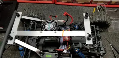

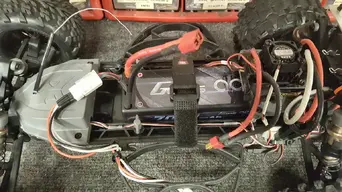

Hi guys and girls, again the AMP is a great open wheel truck when upgraded with the right components. Remember, its an entry level truck, but, when upgraded she will blow your mind. For beginners, if you want speed go with the lower turn motor and gearing, if you want to to do wheelies, go with the higher turn motor and gearing. You can also replace your stock rear tires with larger ones which also will give you more speed and do wheelies if you are in to that. Next would be a 2S 5000mAh 30C LiPo battery for even more speed and longer run times.
Now that said, you will need a good LiPo battery charger, and some good cooling of the motor and ESC as things will run a little hotter. Brushed motors don't last to long depending on how you use your truck that's why cooling is so important. You can buy ESC fans for the ESC but there really not that efficient on moving air. You an use the smaller computer fans and run them on an auxiliary battery which moves more air then the RC esc and motor fans. Most computer fans are 12 volt and will run on a 7.4 volt LiPo battery, or for around 24 dollars you can pick up a small 3s 11.1 450 mAh LiPo drone battery, the fan will run for ever as it has very little current draw. Use your imagination and ingenuity on mounting the fans. You can also mount a micro switch or a button switch to turn the fan on and off if you wish. HAPPY RC'ING.
