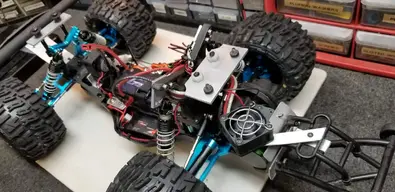

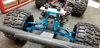

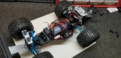

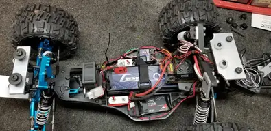

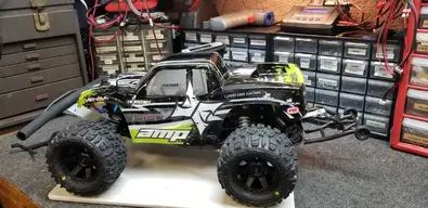

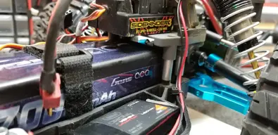

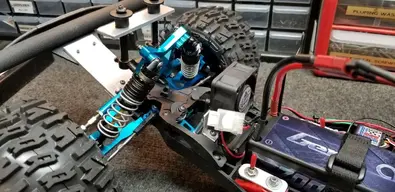

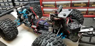

Hello Mike, congratulations on your Amp, it's a great starter RC truck. It was my first RC truck and to this say one of my favorites out of the 24 rc's that I have. When I bought mine I paid $ 149, I would say now it's worth about 350 to 375 dollars if I was to sell it today, which I wouldn't. Mine is totally upgraded from suspension to motor and battery.
I run mine on a Gen Ace 7000mAh 3S LiPo and a Castle brushless 4600 combo. I would recommend that you do your upgrades a little at a time if you are short on money. I hate saying this but you can get some good deals online eBay, remain ECT. However I do like supporting our local hobby shops as they are disappearing in front of our eyes.
Also I might mentioned, you can put bigger tires on the rear and get more speed also. That up grade will cause more heat on the brushed motors so cooling with a good CMF 5 volt fan will help. With the Amp you have to use your ingenuity to do certain upgradeds, for instance there is no rear bumper to add a wheelie bar (which you will need if you go to bigger tires) so you will have to design your own mount. There are a lot you can do to upgrade your Amp just think it out as it's a great accompaniment when done and you did it, and if it didn't work, re-design it.20190109_165658.webp20190113_200425.webp20190108_163509.webp20190108_163305.webp20190108_163249.webp20181206_182207.webp20181206_182150.webp20181206_182133.webp
Also I might mentioned, you can put bigger tires on the rear and get more speed also. That up grade will cause more heat on the brushed motors so cooling with a good CMF 5 volt fan will help. With the Amp you have to use your ingenuity to do certain upgradeds, for instance there is no rear bumper to add a wheelie bar (which you will need if you go to bigger tires) so you will have to design your own mount. There are a lot you can do to upgrade your Amp just think it out as it's a great accompaniment when done and you did it, and if it didn't work, re-design it.View attachment 4658View attachment 4659View attachment 4660View attachment 4661View attachment 4662View attachment 4663View attachment 4664View attachment 4665
