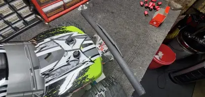

When my 7 yr old nephew takes the wheel. I install the “FreddyBumper”. Its helps with impact and scuffin’.
Sixstring, this is what i did to my Amp. I have one of the older Amps so i had to do a lot of mods on it. To this day, out of all 32 of my RC's, its my favorite. The front bumper is 1/2 inch rubber drip system hose, the thicker hose. It works great and protects the steering and tires. I have taken some hard hits (running into curbs) and it has saved me a lot of down time.

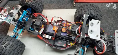

View attachment 5932View attachment 5933View attachment 5935
Did you make those extensions for the bumper mount?

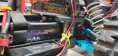

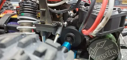

Yes i did, i get all my aluminum from Home Depot or Lowes. There is a lot you can do to an ECX Amp, it doesn't look like it, but you can do lot of mods to that truck. You just need to take the body off and look at and figure out what you want to do to it and how you can do it. I run mine with a Gen Ace 7000 mAh 70cC LiPo but had to lift the battery compartment in order for the battery to fit. My Amp is an older version and the battery compartment is part of the rear suspension so i had to some ingenuity to raise it. I use a lot of aluminum spacers to raise or push out a part on the truck. I will try and send you some pictures. Another thing i do is get rid of all the self threading screws and replace them with M3 machine screws. You can order all different sizes on eBay. You can see the spacers i used to raise battery compartment. If you look closely you can see the turn buckle is connected to the battery compartment, ence part of the rear suspension. The newer versions of the Amp are not like that, ECX changed the design so its easier now to raise the battery compartment.
