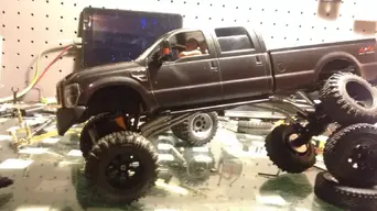

Just a new guy building the temperamental temper
It's got a full frame, new links, cut shocks up front,no springs, been to busy to install the proper fronts,rear shocks are aluminum, 2 piece rims, huge offset, aluminum driveshaft tubes, u joints are now steel with pins,rc4wd tires, savox servo,custom wound 100t motor,7.4 lipo with cutoff,aluminum steer links,swapped to losi transmission, aluminum trans skid,can't recall the gear ratio now, aluminum gears, converted upper link to run off top of axles, damn thing even has lil brakes on the wheels lolWhat all have you done to your Temper, besides the obvious exterior mods?

Think Colorado lolTruck looks great @TheFordGuy, but that dude is certainly getting lung cancer with a cigarette the size of his head!
Nice truckThat's my 1:24 temper superduty build. Didn't know there was a site or anything like this for the little ECX's.
