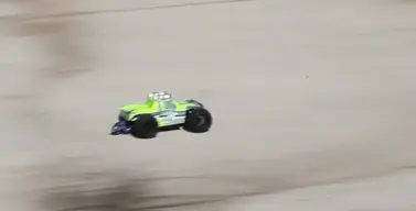

GoolRC 3650 Brushless with Gool ESC
3S Lipo
1/2 CD case cover taped to front of body to reduce lift/wheelies
Ebay cheap wheelie bar taped to back brace
Ebay metal gear servo
Ebay wheels/tires
Ebay front/rear LEDs
ECX metal gears
48 mph (GPS) with phone taped on the hood
This video clip is w/o the phone the reduced weight up front prevented me from going full throttle. (crazy wheelies instead)
Taffer
13
The mods in this video are a quick hack-job with a CD case that I cut in half. Although it looks terrible it made a tremendous difference in that w/o it on 3S the truck would wheelie uncontrollably and flip. A more careful mod with a more optimized front aero wing would probably work even better. I was able to control it this way when I had a phone taped to the hood for GPS (and incidental extra weight up front), but in the video I had removed the phone, so it still wheelied.
