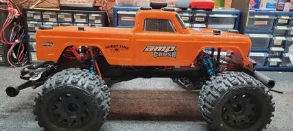

OK...
An update...
I went out bashing with my oldest son, and guess what?
The axles held up on my Circuit, but the rear lower deck where the hinge pins sit, is now up for replacement.
The circular hole is now oval...
Fortunately I have a spare, but with this amount of force being put through the car, an aluminum upgrade is next I guess.

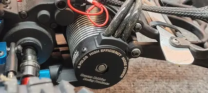

My Ruckus had a different problem.
It has a 2300kv motor, so I tend to use my 3s in it.
Well, I had an axle failure!
Yes, the fix in the above video did work, HOWEVER...
The axle PIN simply snapped...
So, I guess I'm looking for stronger pins, or maybe all different axles...
Gonna keep you updated...
-Dave
