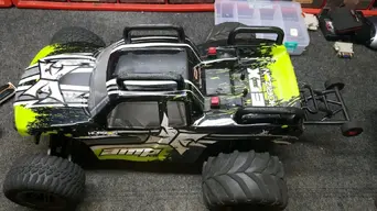

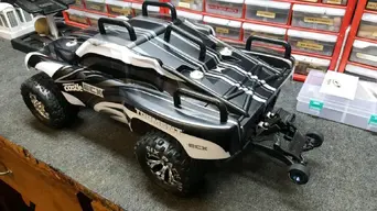

Try this method to save your body from damage. These are 99 cent plastic drawer handles reinforced with .062 by 1/2 wide by 3 1/2 long aluminum flat.
They work great and saves the body from damage.
