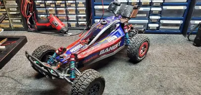

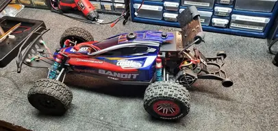

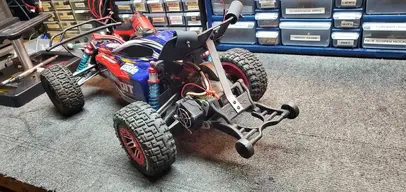

There are many other things you can do, but you would have to spend a little more money. As far as the GoolRc combo's goes, I will say, I put one in one of my sons RC trucks and haven't had any issues yet. Yes you can play with the gearing for more speed but then you will run into controlling problems and overheating motors, which can be solved with a little more money. For now I would stay with the stock gearing but would go with harden steel for the pinion and spur. I would also go with steel differential gears also. Hope this helps. This is my latest homemade upgrade on my Traxxas Bandit. I built a better and stronger spoiler, much better then the stock flimsy one.
