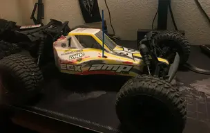

Castle SW4 + Weinan 3650 4-pole 5200kv Brushless Motor + Traxxas 3 channel receiver + Traxxas 2075 Servo
Stock Pinion Gear (18t) & Stock Spur Gear Running on 5000mAh 45c 2s LiPo.
This ones a wheelie machine but it drives on point & the entire system runs extremely cool (y) [even w/ heavy bashing on grass]

I see you're still running stock axles, have you upgraded the trans to all metal yet? And how long have you been running this setup?
The transmisison is still stock & everything has been running great so far. The only issue I'm having problems with is the hinge pin/rear a-arm. It seems like when it popped out the first time, it stripped the plastic so now it will pop out easily If i catch a bad landing. Looks like I just need to replace this part (even the reviews complain about the same issue) https://www.horizonhobby.com/front-rear-suspension-mount-set:-1-10-2wd-circuit--boost-ecx1092
I had 3 Amps, and yeah the hinge pin holders do wear out early. I bought 3 replacements before I drilled it out and added long screws with nylock nuts. Haven’t had any more issues. I fabbed up an aluminum pin holder for the front and that solved the bulkhead breaking up front. Pretty bomb proof now.
