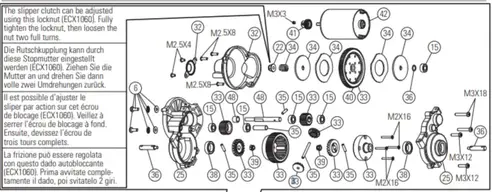

Have you taken the gear cover off and looked at the gear teeth and slipper clutch? If the gear teeth for the spur and pinion look fine, check to make sure that the nut on the slipper is tightened all the way, then backed off a little. If it was too loose you likely need to replace your slipper pads.

I'm not completely familiar with that setup, but it looks like that slipper might be loose. I'm used to the slipper spring being compressed more than that. The manual says to tighten completely and back out two turns. Is that what it is presently set to?
