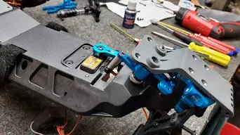

If your running on the street, track, or dirt, without any jumps and turning the wheels and vehicle stays straight, then the servo is returning to center. I had to grind away some material from the servo cover as it was rubbing against the inside of the cover.
There is a brace that covers the servo arm that appears in neither of our pictures. Since the aluminum arm is more bulky than the stock one, the circular part was contacting my brace but just barely enough to make a witness mark. I clearanced it very slightly with a dremel and a sanding drum.

This is the skid plate I was referring to. I'm not sure if the picture shows it but if I shine a light from the backside there is a paper width clearance for that servo arm now and that seems to be plenty. It looks like the one on Hot Racings website is a little lower profile if you want to go that direction for a 25T servo horn.
