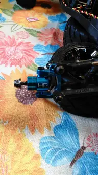

So on to the next episode of the shoulder screw saga... Today I lost a screw again. I couldn't find it back so I don't know what condition the threads were in. The Hot Racing spindle looked great. Probably the screw worked itself loose from catching sand between the spindle block and the shoulder, then gradually unscrewing itself each time I turned. In the aftermath of the accident I also cracked the caster block, it's hanging on for dear life now.
So... Hot Racing aluminium spindles and super glue for thread locker didn't eradicate the problem. I don't know if it was the crash that caused me to lose the screw or the screw that caused the crash. Either way, it's not over yet.
With the aluminum spindle carriers you can use blue threadlock. That will probably work much better than Superglue. Just make sure you keep it away from plastic parts! If you just put a dab on the screw threads, let it dry for a few minutes and then install you should be okay without any worries about it getting on the caster block. Superglue is best (but not perfect) for nylon plastic parts.
Alright thanks for the tip. I'll use blue loctite next time I lose one, lol.
So I am done with loosing shoulder screws!! I just ordered the HR Aluminium caster and steering blocks. I really didn't want to go aluminium but I guess i have too. Also I am loosing the over-sized bearings, but I'm sure i wont notice that.
Let's see how this works out. I put blue loctite on all of the metal to metal connections. The only thing I'm waiting on is the new set of shoulder screws, order 2 sets just in case. Unfortunately I'm back to running the stock bearings.

I have been using HR aluminum steering blocks in mine with blue loctite without any issues. XlDooM, you lost your screws in your aluminum steering blocks because you didn't use proper threadlock (CA should have never been used here). I got another set of HR blocks for my son's AMP too as his (like all others) is loosing the screws too.
Personally I think the HR steering blocks is the ultimate, cheapest, simplest method for fixing this issue. Been working fine for me. Sure beats all that swapping out stuff
What aluminum hexes are those? Looks wider than stock. Know they are 12mm hexes, but I'm wanting some aluminum hexes and want to get the right ones
I believe they are HR or ECX, I need the offset for the 2.2/3.0 wheels
