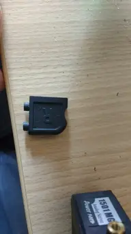

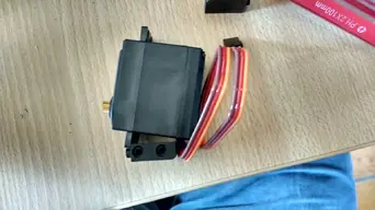

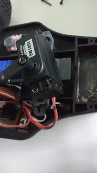

I put in the Power HD 1501MG servo. There were two problems. Firstly, the cable on that servo comes out slighly closer to the front (top? the side with the external gear) than the stock one, and I had to trim the right side servo mounting block so it would fit between the ears and the cable. Then I found out that the mounting ears are too tight on the Power HD 1501MG. I found this out when on the left side, half of the omega-shaped plastic that forms the not-quite-closed mounting hole broke off. It still mounts up solidly so not much of a problem there. On the right side, not only did I break the same part, but I mangled the little tube-like structure in the ECX mounting block that goes into one of the servo ear holes.
I was a bit pissed off at this point and didn't take pictures, sorry about that. The servo is mounted securely still, but I had to give it a dab of super glue just to be sure it wouldn't come out, and it looks quite pitiful with all the mangled plastic :(

You're in luck, I just installed the RPM servo saver eliminator and took a few pics.
Here's the trimmed mounting block to leave room for the wires:
Here are the broken ears:
