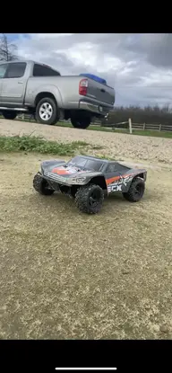

Hey Guys,
I've been searching high and low, but there don't seems to be any obvious options for my little guy. I went out o a 1/10 scale dirt track recently, and the stock tires performed poorly to say the least. I was keeping up with the pack in the straight aways, but it was donuts galore in the turns. Though the soil was hard packed with loose top, I was skating around, doing donuts like on ice, while the 1/10th scale rc10's with better tires were gripping just fine. I realise theres slim pickings in general for this platform, but am hoping there are options out there. Don't care if I have to go with different size hexes, etc, just want some better options.
Update for anyone who'se curious..
Traxxas 1/16 mini slash tires are 12mm hex, fit and work great. BLOW the stock tires away on packed dirt track. Tread is a fraction taller, so with the suspention set to the default super soft, they will just barely rub the edge of the body. U can hear it in the corners a bit. Not a big deal but worth noting.
Part Number: Traxxas 7073a
Anyone got anything else they've used with success??
