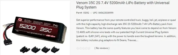

This is what I run on my BL circuit.
How long does it last? Kinda disappointed by the run time of the stock battery.
Depends on how you drive and where you set your voltage cutoff at. 45 minutes to an hour, approximately.
