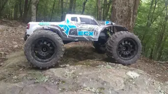

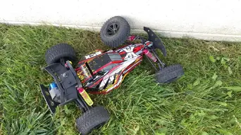

I have both the 3000Kv and 4000Kv Kinexis systems. The 4K is in my AMP Buggy and the 3K is in my son's Ruckus. The 4K is noticeably faster but is a wheelie monster. That said, my buggy is crazy light so it's not hard...
The Ruckus has MASSIVE tires on it, so it does wheelies all day. But it wasn't quite as bad when it was geared down with smaller tires.
That said, both have been really good combos. I'm surprised at how well they've held up. Here's a pic of my son's Ruckus and a pic of my buggy after a collision into a wall...

View attachment 1110 View attachment 1111

My son hasn't broken it much, but I have. It's taken a lot to get to where we're at with it. My son is 5 so yeah...
I upgraded the entire drive train to steel, put 17mm hex adapters on it, 1258TG Turnigy servo, RPM servo saver eliminator, Hot Racing HD Big Bore shocks (stock couldn't handle the massive 6" tires), and steel spur and pinion. Also, T-Bone bumpers.
It's not a $170 truck any more. The tires (3.8 ProLine Shockwaves) were $90. Lol.
But... it's crazy fun! And very easy to work on.
