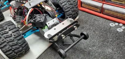

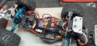

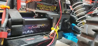

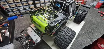

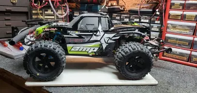

NoobNPain, this is my Amp, totally upgraded and powered with a GenAce 7000 mAh 60C LiPo. I don't baby this truck and its been clocked at 60 plus mph. I haven't broke or striped any gears, so I'm curious why you would of striped out your trans gears.

No i dont think that's the problem, i did the same to my Amp, i took about a 3/16th off my adjusting slot and have never had a trans problem. Im wondering if you might have some type of binding going on in the tyranny case. Maybe you lost one of the gear shims. When you put the new steel gears in and put the case back together, before you mount it back in the car make sure it spins freely with no binding or grinding. Also i would recommend that you put some lithium grease on the exposed gears, I do this on all my RC tyranny gearing and have yet had problem. Those gears get hot from the transfer of heat from the slipper clutch along with the friction of the gears themselves. Hope this helps, give it a try can't hurt anything.
