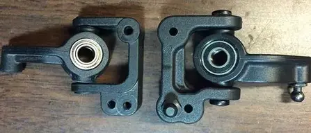

After the steering bellcrank upgrade, I moved on to the RPM caster blocks and RPM front spindle blocks. These components removed a tremendous amount of play that was present in the stock setup. As you know, the stock steering knuckle can move up and down in the caster blocks. The RPM spindle blocks remove all of this vertical play. Together, the caster blocks and spindle blocks do much to reduce front-end play on the 2WD ECX vehicles. In the photo below I compare the stock assembly (left) to the RPM assembly (right). Actually the RPM components aren't bolted together, yet you can see that the spindle block hasn't tipped over due to it's close fit with the caster block. Despite being a close fit, there is no binding and little friction. I expect this to free up even more with use and normal "wear and tear."
In this next photo, I've placed the two assemblies side-by-side to get a better sense of just how much stronger looking the RPM components are compared to stock. Even with their burlier construction, there are no fitment issues and these are a "bolt on" upgrade. As an added bonus the the cartridge bearings are slightly larger than stock (11mm diameter vs. 10mm diameter) which RPM claims doubles load and fatigue ratings. As with the bellcrank assembly, I think these components will easily outlive the rest of the vehicle!
After completing the installation I did notice that there seemed to be a little binding once the wheel nuts were tightened down. I'm not certain, but I attribute this to the rubber seals in the new bearings; the stock bearings only had metal shields. I believe that this will disappear once the lubrication in the bearings begins to "weep" past the seal's inner circumference.
Here is the stock steering assembly:
And here is the RPM assembly:

So I have all of these rpm parts as well as the rear parts. Today I ripped the shoulder screws out of the front drivers side spindel block. Has anyone had this issue and came up with a fix
@mrc82 I noticed that when I was installing the RPM parts that screws seemed to thread into some of the mounting holes really easily.
After a few weeks and some hours of track time, I've discovered that the ECX ball studs I've mounted to the caster blocks and rear axle carriers (for camber links) manage to work themselves loose. I contacted RPM about this and they recommend the use of regular CA glue ("superglue") as a thread-locker. DON'T USE conventional thread-locker as they are not compatible with plastics and may deteriorate the plastics in the components.
I applied just a drop to the threads of the ball studs and this seemed to help prevent - but not eliminate - the studs working loose. However, I use some old glue so it may not be as effective as it should be.
I don't think those spindle blocks are intended to be a flexing part, are they? You could use a two part marine grade epoxy and it will never let go.
