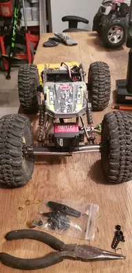

She is coming along!! Love this thing!! Servo horn is temporary as my old metal one is not fitting lol!!20190424_212840.webp
