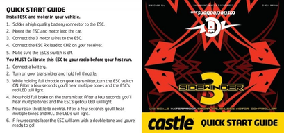

Its all in the manual if you have it still. Here is the procedure. Castle quick start guide. As you can see it says YOU MUST calibrate it. Its going to be a lot faster truck after you do this at least it was when I did it on my ruckus. Dont worry about it saying before first run. I didn't notice this till like after my third run lol. Also I had to have my throttle trim set to max for it to calibrate.
Alright yeah haha. I still have all my guides and manuals and it said to adjust the punch control limit to pop wheelies.
Did you calibrate and try it out and did you find a difference? I know for me once I calibrated it was like a different truck.
I mean I did calibrate it first time I started it up but with default settings. But I didn't even have to program the esc and only tightened the slipper 8 turns then gave it a test run and it started popping wheelies already.
But the programming part I left cause I think its better if I have the castle link programmer cause not the best at doing it with a transmitter. But thanks anyways for your help.
