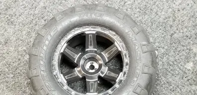

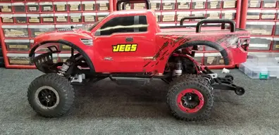

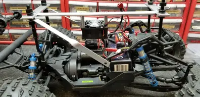

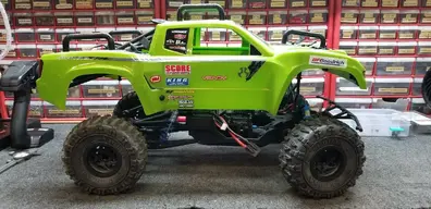

@JonnyO2, you can use the Badlands 2.70x5.05 or the Proline Masher 2.78x4.90.
If you are new to this hobby I would start out with tires and maybe a good 2S battery (I use Gens Ace batterys) and see if your daughter or you for that matter, enjoys the hobby. From there, if you find it enjoyable I would start to upgrade and buy more vehicles.
The initial buy is the most expensive, the car, the 2 or 3 cell battery, the Lipo charger, which is a must for LiPo's. Other then that, parts are pretty cheap for RC vehicles.

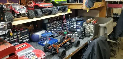

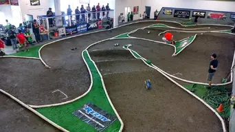

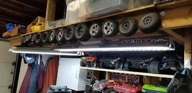

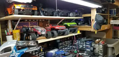

I myself have 24 RC vehicles and go to our indoor race track to help the kids (and adults) with some tips and to keep their cars on their wheels. It's a lot of fun and so enjoyable watching these kids having a ball racing their car's.

Awesome. Nice seup! And thanks for the specs on the wheels/tires - so it looks like a 2.8 12mm is the right size after all.
Your welcome, and thanks for the kind words. I do have a lot of RC vehicles as I do a lot of experimenting and mods and repairs for the kids (and myself).

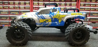

Here's a couple of mods (body lifts) on my Yeti and Traxxas.

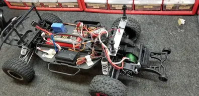

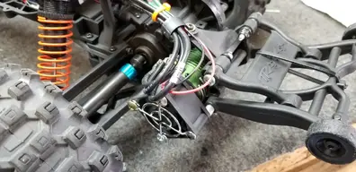

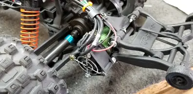

Johnny, I want to mention, if you put bigger tires on the rear you will get a little more speed and your brushed motor is going to run hotter. Here's how you can mount a fan on your Ruckus . I use computer 12 volt fans and run them on there own separate 11.1 3S 800mAh battery (about $24), I use them cause they push more air. You can wire it to a switch (the best way)
or wire it directly to the battery, either way you will have to change the plug on the fan to a JST male connector. If you use a 5 volt fan you can plug right into the receiver. You will have to change the plug to a mail servo plug.

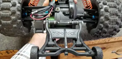

Johnny, if you don't put a wheelie bar on, you can attach a piece of 1/8 thick rubber onto the skid plate (the motor guard) to keep from wearing out the skid plate which you will after awhile, that's what happens to me, but I put on a wheelie bar. It's really a job to put a wheelie bar on the Ruckus as it has no bumper so you will have to use ingenuity and designing. Have fun and you and your daughter enjoy the hobby, it only gets better.
