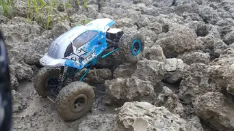

Wow what a difference some slightly bigger stickier tires can make! I'm now trying to find new obstacle it can't climb! I definitely need wideners because rollovers are still all to common and these bigger tires rub bad at full lock and full stuff.
