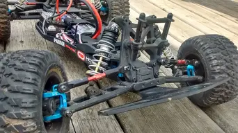

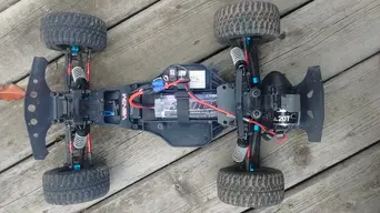

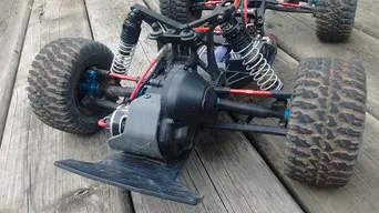

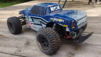

Hey everybody! I realize I haven't been keeping this thread up, but the summer has been busy as all get-out, so... I've gotten out with the AMP's and my son quite a bit over the summer, and we've been having a blast so far. I've gotten my AMP to a relatively solid place, I think, in prep for eventually going to a brushless system. My list of upgrades as it stands goes as follows:
- RPM A-Arms on the front and rear
- RPM transmission cover with quick release slipper cover
- RPM front Axle Carriers
- RPM Ball Cups on the steering links
- Traxxas Turnbuckles all around
- Traxxas links for the steering assembly
- Hot Racing front Steering Blocks
- Hot Racing rear Axle Blocks
- Hot Racing steel telescoping drive shafts
- Hot Racing aluminum Bellcrank
- ECX Aluminum Hubs on the front (the rear has the steel ones that came with the drive shafts)
- ECX Metal Gears
- T-Bone Racing Bumpers front and rear
- Fast Eddie sealed ceramic bearing all around
- Pro-Line Powerstroke Shocks front and rear (got 'em on clearance for cheap!)
So far so good! I've also just picked up a Tactic servo from my LHS, as I grabbed a bunch of concrete at a skatepark recently and stripped the servo horn as well as cracking the case of the stock servo. Seems to be working well enough.
Anyways, on to the pics!
