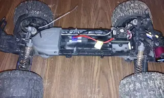

my ruckus... so far
Joshnewb
192
  • rpm front A arms - wrapped one around a sign post
  • rpm rear A arms - just got sick of rocks getting stuck
  • ECX HD rear axles - rock in suspension arm chewed one up
  • team associated titanium steering/camber links - adjustability
  • rpm rod ends
  • team associated 8mm ball studs - ECX too short
  • rpm oversized rear hubs - with AE ball stud, threadlock, and M3 lock nut
  • rpm oversized front steering knuckles - will be switching to Hot Racing Aluminum (and threadlock) soon, sick of searching for shoulder screws
  • rpm caster blocks - why not? and didn't wanna bend aluminum ones
  • acer, trb, and fast eddy bearings
  • ECX aluminum wheel hexes - one stripped wheel was enough
  • ECX aluminum shocks (30wt front and 35wt rear)
  • team associated low friction x rings - slow leak shocks starting to get old, still in package as of yet though
  • team associated shock springs - went stiffer front and rear, better on jumps, seem to help street handling too
