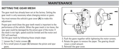

So I pull the trigger and something is spinning but it isn't the wheels! Where do I attack this from looking at the truck from the rear...the left side or the right side or does it matter? I'm assuming there's a gear stripped somewhere in the transmission.
