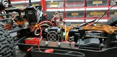

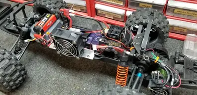

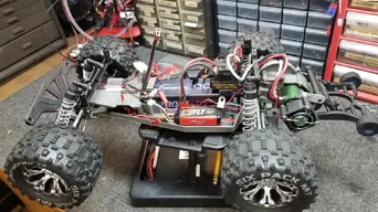

WaterLoupe, There are some great brushless motors out there. I myself run the Castle combo's on my cars and trucks, they run around $ 110 but you can pick them up on eBay for a lot less. I usually run the 3600kV to 4800kV. They come matched with the Castle ESC. The lower the kV the more torque you will have off the line and a little less top speed. The higher the kV the less torque but more top speed, so it all depends what you want and what you do with your vehicles. I do a lot of street racing and some 4 wheeling. It's great hobby and the parts are cheap accept for the initial buy of the vehicle. The most expensive items are the LiPo batters, brushless motors and tires. Also going to all steel or harden steel and aluminum parts can get a little pricey, but still cheaper then the above mentioned. If you like the hobby it will take you awhile to get up to par on repairing or upgrading your vehicles. As you can see from the images I do a lot of up grading and use a lot of cooling. The fans run on their own LiPo drone battery and are switched. Once you familiar yourself with the hobby you will be able to do the same. There is a lot of info on this forum and a lot of smart people, some smarter then me, so anytime you need information we are all here to help. Happy RC'ing
