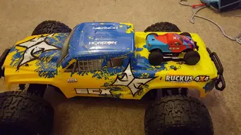

I'm new to rc cars and just bought the brushless ruckus 4x4 with avc on sale. Is it possible to fit the torment body or similar stadium truck body without making any modifications? Any other advice on running this awesome car also appreciated ☺

The tires of the Ruckus are to big for a Torment / Slash body to fit properly, You will need to get some wheels with tires designed for a short course truck and then you will also have to change the body posts and then lower the truck.
Epic truck, I personally don't mind the stock body but I can see why you'd want a new one. There be some mods need to make a SCT body fit
You could experiment with cutting the body but I'd reccomend getinng a cheap one to try that
4x4 torment body and wheels is all you need. Ive done it. Way better than the ruckus. Only good thing about the ruckus body over the torment body is it keep all the dirt mud n water out.
