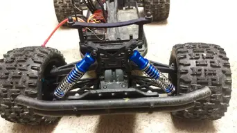

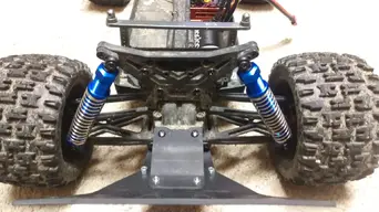

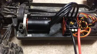

I added some GPM shocks from AsiaTees when I put the new motor in. The motor is the MX550 3500Kv from Maclan and the Diamondback 120A ESC from them as well. I'm looking forward to playing with it VERY soon. :D

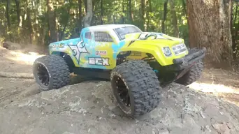

Also, painted the new body. And ECX sent Circuit decals with the packaging. Ugh... but I'm happy with my paint job.
