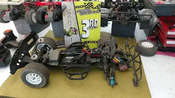

Here is my shock setup that I feel that has really, really been successful. This route is way cheaper then going Proline or others per say.
Purchased the Traxxas 2wd Slash Ultra w/white springs, front and rear plastic shocks. Used the interior parts and swapped over to aluminum housings.
STRC brand;
#ST3767R (red)
#ST3765XGM (gunmetal)
#ST3766XGM (gunmetal)
Used 2 hole pistons with 30 weight oil.
Team Losi Racing brand springs;
TLR5182, 3.5 rate spring on front
TLR5171, 3.4 rate spring on rear
This shock setup gives you an lower ride height/lower roll center, which gives awesome handling. Adjustment of washers to springs, gap on front and just touching on rear. I used a calliper to get exact distance to match to other side.
(Side note, you can take your stock shocks and install Nitro fuel line (or clear vacumm line from parts store) cut to 3/16" lengths and install inside your shocks to give a lower ride height).

Here's some photos. Some carnage. Yes, these are entry level hobby grade RCs that take a beating and keep moving. They can be setup to be competitive. They are an awesome chassis to learn and build and grow from. They will not be on top podiums but they will be the ones that stay strong.
