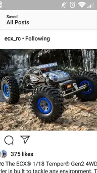

Has any one seen the Gen.2 temper? what are your guys's thoughts on it? also anyone thinking about getting it or using parts/the body from it?
O yeah i saw it got my first ecx temper as a starter truck for my 3 yr old and it has been amazing now my original thoughts where when he out grows it I'll dump some upgrades into it and have a mini for my self now that the gen2 hit the market that thing looks like a purpose built comp crawler

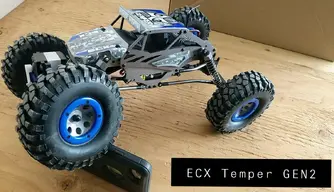

So I've been modding mine. First, the servo is incredibly weak. I replaced it with this:
https://www.amazon.com/gp/product/B073M8QT1S/ref=ppx_yo_dt_b_asin_title_o01__o00_s00?ie=UTF8&psc=1
The metal servo horn is a nice addition. I rounded the front edge to give it better ability to climb without dragging. The back of the servo arm needs to be clearance to clear the steering.
Next upgrade was the battery. I'm not running a 2 S lipo. It give more run time as well as a bunch more torque for climbing. If you add this battery, you will need to replace the connector as factory it comes with a EC2 connector.
I did added bead locks to the tires. These wheels added 2.2 oz per wheel so it increased the weight of the truck which aides in its climbing. I will say they look really cool but are a enormous PIA to do properly.
Lastly, I looked into those shocks again. I discovered that 2 of them were hydro locked. I removed them from the truck, pumped them dry and re-filled them. This time I put lighter weight oil, 20 wt in them. Previously I put 35 wt on top of what ever was in the shocks. Articulation improved but I chalk it up to the shocks not being hydro locked.
That's it for now. I have a Hobbywing 1080 ESC sitting in the shop. It will be the next addition. I'm also considering Hot Racing's Piggy back shocks: https://hot-racing.com/?partnumber=TD80RV02;c=964
