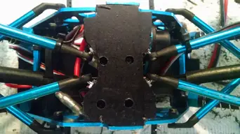

How's your rig going Jon? I need to do something about my balls again. I popped one out of my skid/nut plate. I was thinking about copying your idea, but changing the stud mount angle a little steeper so the rods will be paralell to the ball equator and I want to try with Teflon. I just dont know if its hard enough to tap a thread into. Especially that fine. That aluminum was a bad idea on mine. The rocks dig and bite into it. Hangs up more often than I think it should. I wondered if you had a problem with them wanting to pop off at the angle you have there?
@1hitw0nd3r - skid plate measurements: roughly 6mm wide by 3.5mm long. I followed the factory plate for outside dimensions. Where to place the ball-studs was mostly just based on a mental idea (my first cut didn't allow enough room to install the second stud, so I had to make it a little wider) - measurements there weren't recorded, but were based off of the middle of the plate. The rest was "eyeballing" locations that looked like they'd have the least bind. Someday soon, I'll have a set of calipers I can make good measurements on.

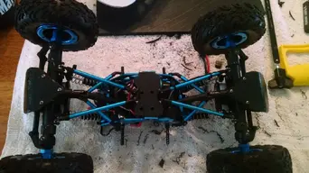

@Mark @r8derhed5150 - I've been driving mine mostly since I finished the 4-link and added weights (when I haven't been shopping, wrapping, etc.). I do want to upgrade the servo, possibly do the 4-wheel steer (the rear pushes too much sometimes when I want to turn) or some kind of dig/disco for the rear axle. Considering a power upgrade both to LiPo and a bigger motor (I've heard the Dromida 370 motor will mount, but cant get any details on what needs to be modified other than maybe the pinion gear), although I think the LiPo will wake up this little 280 a bit. Brushless is a whole new ball of wax I'm not ready for yet, but I'm still curious about.
I did have one ball pop off the servo plate, but I attributed that to the fact that I was using the cut-down ball-studs from my old skid plate mod - they were too short to make it all the way through the plastic. I ended replacing those with full-length ball-studs. Those poke through a little too much, but the servo will still mount, and I haven't had a problem since. I did note that my rod-ends at the skidplate side are wearing against the rocks, so the next design may have them mounted up a little higher (so the skid hangs below the rod ends - it may hang up on the plate though...).

Your 4-link looks great! How's it working? What was your base material for the skid?
@Juanmarteen I went to munell and Sherrill and just picked up a sheet of reminents. I drilled holes half way through and then screwed the screws in so they wouldn't catch on anything. But my motor keeps getting to hot and I'm wondering if there's anything you can do to not get it so hot or maybe an upgrade to the esc? Are you putting that esc in the temper? I don't think the motor handles the 4 wheel steer to well. I just picked up a 2s lipo 4000mah battery and it does give it a bit more torque and power but once my motor gets hot which happeneds fast it loses all power
