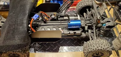

My Ecx 4x4 Torment is now upgraded to
Hobbywing Ezrun 4268SL 2600kv (3000W) 4 pole brushless 5mm motor + 14T/45T 1 metric 5mm
Castle Sidewinder 4 esc + R1 Wurks 30x30x15 heatsink fan
3S lipo Reaction 30C 5000
3S lipo Lectron pro 50c 5200
Shock oil 60 allround...
Even 2S lipo is fun....
....Previous upgrade with 4000kv 4 pole overheated eventually on 3S....
Perfect 4x4 short course truck beastie for driving the Mod 1 gears offroad and drag racing punch... will be fitting a 18T pinion
HW warm after several minutes hammering full speed blasts on road on fresh 3S lipo......

VikingRc,
Do you have a bit of spec on the mesh cover you have made please?
I have been looking to sort one for my truck.
Sure.
Screen door roll. Large insect pet mesh. Measure more than you need to cover chassis with room to ziptie it. Cut down with scissors... take your time... custom fit it. Still working out best velcro adhesive
