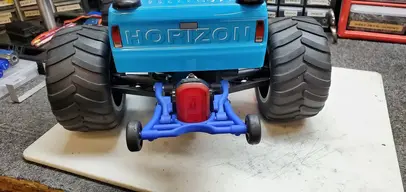

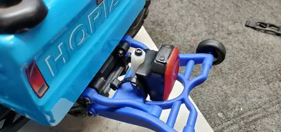

and whitch tbone wheelie bar will fit the amp mt and will the V3 Snow Skis - ECX Circuit ST, Ruckus, Torment SC 2WD
fit the amp mt
